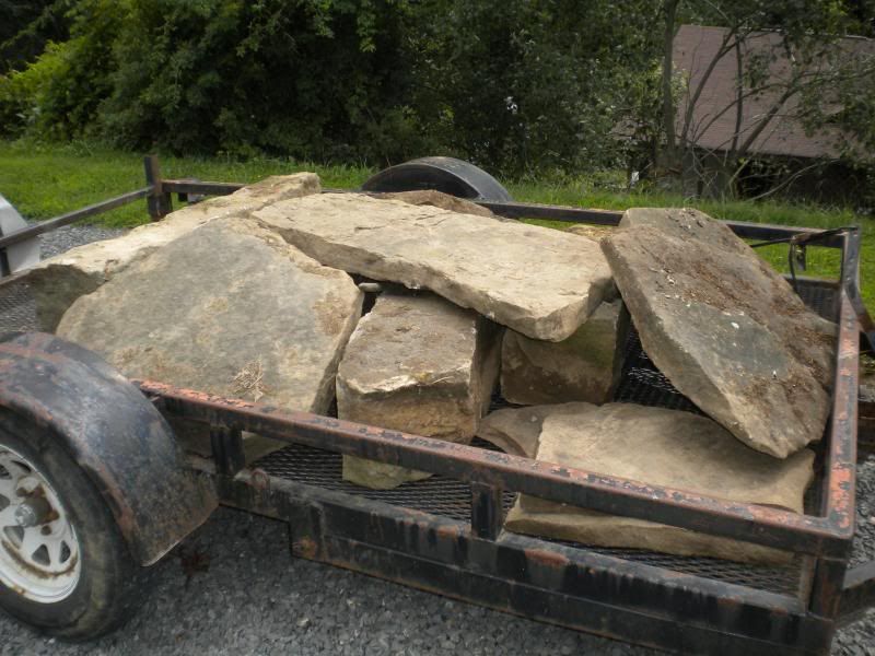

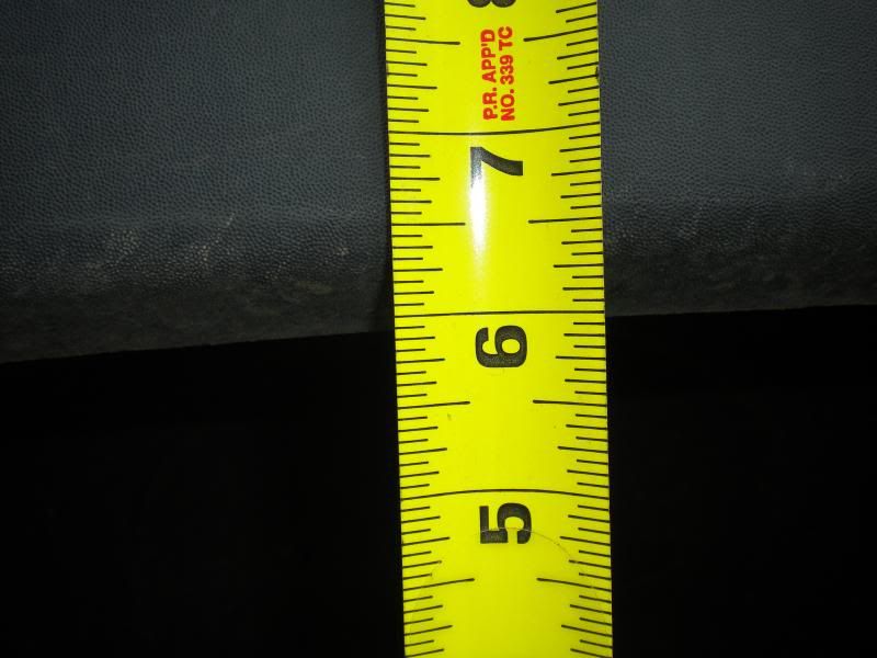

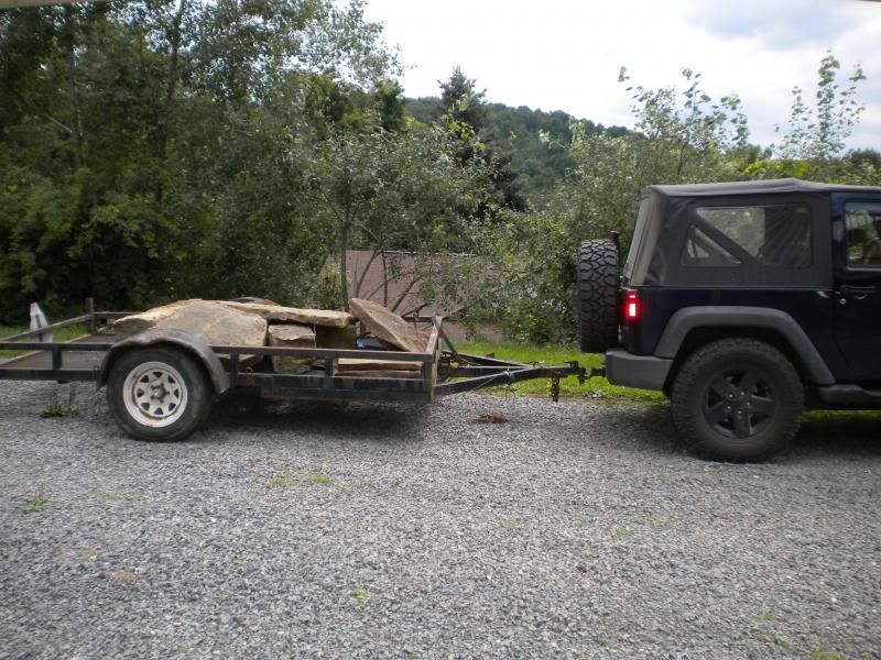

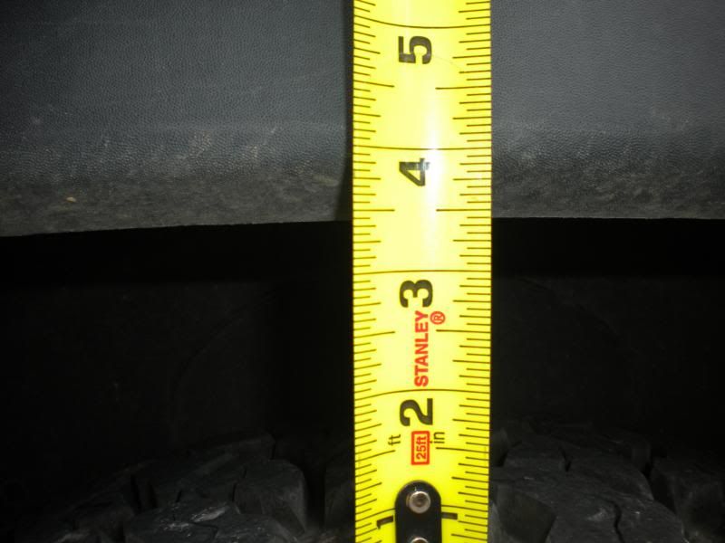

I put the coils to the test today. Hauled a load of flat rock and cut stone. I'd guess there is probably about 2,500lb of stone on the trailer and a healthy portion of it on the tongue. This will be as much as I plan on towing or hauling with it. The rear compressed about 2.5" with the load on it. The coils handled the load much better than the stock coils would have.
Loaded (Rear tire to bottom of flare)
Unloaded (Rear tire to bottom of flare)

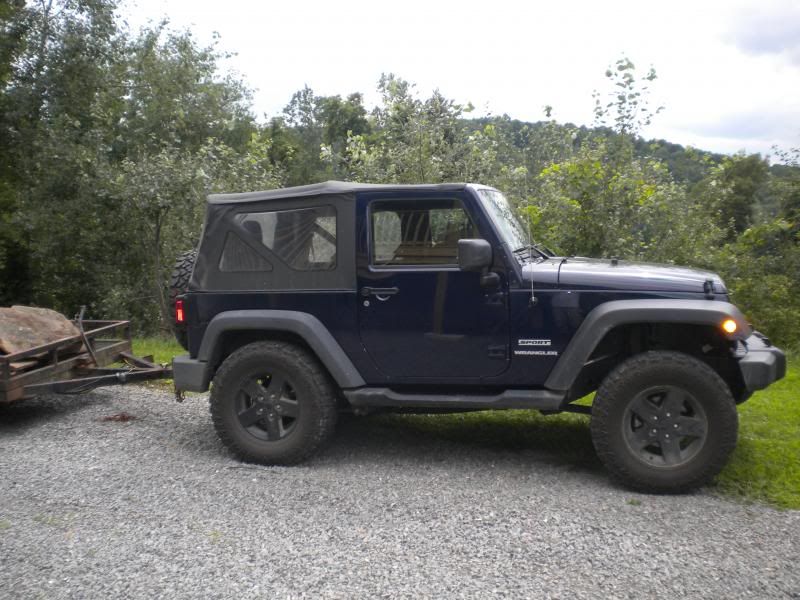

18/60 coils, 1.25" wheel spacers, and 35x12.50R17 Goodyear MTR/K
